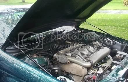

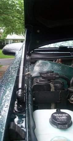

I have made a hood strut relocation setup for the GEN 2 Carbon Fiber hoods that only require a drill and a wrench. I am trying to gauge the interest some people might have for this setup. I have it on my car and feel it can be duplicated. There are no problems with closing the hood with them connected. It is a true hood strut relocation.
Here are some pics of the kit on my car:
HoodStrutRelocationLeftSide HoodStrutRelocationRightSide
HoodStrutRelocationFrontView
This kit would come with the two good used hood struts (not SHO hood struts) which are welded to brackets and two lower mounting brackets that would just need to be drilled and bolted in for the fender mounting.
I haven't quite worked up a price yet so any suggestions would help.
Any Interest???

For the people with fiberglass hoods, would this setup work for them?
I do not see why not. It actually bolts onto the upper hood mounting bracket which is on every Taurus whether SHO or not. I can check to be positive though.
A lot of people will prefer new struts.
I understand that completely. The only thing is that I am not a company, just one guy with drive to do it and provide a product for some other people.
I have a stock hood and would like this done.
Those with a stock hood would be best getting their relocation kits from ShoSource. They have them available, but it does not work with some Carbon Fiber Hoods. I would be more than willing though to make it happen for you. I would just make the hardware and then you can attach your stock hood struts to it.

Are these lower strength struts?
Yes, they are trunk struts not hood struts from another vehicle.
it's just that the struts are so strong you get terrible cracking sounds if you try to close your hood. . .
Those cracking sounds are actually from the fiberglass cross section that is glued/rtv'd to the inside of the carbon fiber hood. Those section tend to break over time and cause a cracking sound under flex. I noticed that I didn't like how the hood sort of bent when only one hood strut was installed, hence the idea of two weaker hood struts.
I use only one strut with the relocation kit on my cf hood
That will work. I wanted it to be fully functional in every way though on my car that's why I came up with this setup. All the relocation kits I have seen either require the hood strut to be removed when closing the hood or only one was used.
