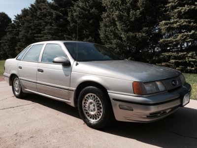

Hi All,
I’ve had two 1989 SHOs since the mid-1990s, my current one I’ve had since 2004 that I paid $200 for from a friend (to cover the two new front tires he put on) who only wanted a case of beer for it. It sat in storage until 2018 when I decided to get it out, get it going and roadworthy again. We’ll, it’s on the road with a bunch of new parts and elbow grease, but I’m still chasing a miss.
