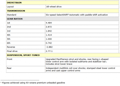

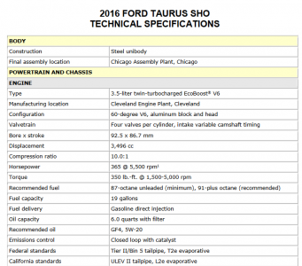

Welp, fords spec for h.p. and torque have an annotation that the numbers were on 93 octane. I also recall that the owners manual days the car can run on 87, but 93 is by no means going to hurt the car. Your not going to get everything out of the car when you smash the go pedal.
If you dont have the owners manual you can download it from fords website from the owners website.

Are you aftermarket tuned to run a particular octane of gas? The factory computer programming is able to adapt timing to run most grades of gasoline. The higher the octane the more timing it can advance and should run better.
It seems counterintuitive since 87 octane has more energy than premium-- but premium formulas keep the fuel from igniting too early as the piston compresses the air and fuel toward the top of the cylinder (called knocking or preignition). The computer will retard ignition timing when it senses preignition and that typically will cause a little slower acceleration.
If you are running a budget and gas gets too expensive you won't hurt anything running 87. The computer will compensate

Mine is tuned for 93 but I'm almost sure I read in the manual that it was preferred to run 93 octane from the factory.

Yes, can handle 87 but should run 93. I’ve tested it more than once in the first year I owned mine and not only did I see noticeable performance improvement but better gas mileage as well. Nothing drastic, but better nonetheless.

93 is only "required" if you have a tune for 93. In stock tune, the car will figure out the spark/fuel mix is needed for the fuel you put in. Even with cold air intake mod, the car still figured it out -- as optimized by Ford. If you put in an aftermarket tune, you should have a choice of what octane fuel, then follow that. Knowing that my SHO is not driven daily and that gasoline loses about 1 octane per month when sitting, I set my tune for 91 and when I am at home, I fill with 93. On road trips, knowing I will use up whatever mix is in the tank, I will fill with 91 or 93 (which some states don't seem to have), and then top off with 93 (always available here in Northern Virginia) when I return home and know the car will sit for a few weeks.
