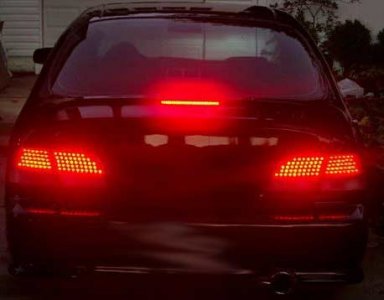

Here's what I mean by the "G35" mod for those wondering why a Nissan product is mention in a SHO forum :)
Zmax2
Zmax2 2

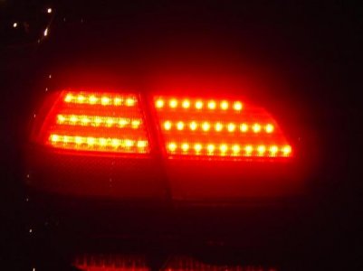

Now I am very lucky to have my bud's Maxima club near me to pick the guys brain who made/finished his LED("G35") mod on his Gen IV Max above.
My reason for even posting this right now instead of finishing my own "G35" and surprising everyone is if I were to make 5 more extra sets for our SHO's would any Gen II owner be intersted in purchasing these LED's??? Already pre-soldered and with installation instructions for around...well i'll have to find out how labor intensive this will be but wont be too outrageous of a price.
Any round figures on what I should charge figuring a good 50hrs of straight labor if not more?

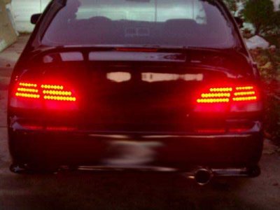

BTW for those imagining what 5rows of LED's will do for you at night when braking here is a better picture with all them on instead of the 3row "parking/driving" lights shot you see above of my boys Maxima.
Zmax 3
And what Super White 15Kmcd LED's will do for your reverse lights evil_gri

Just a question, do they dim half way with the driving lights on, I know you said the 3 rolls on the Max was for driving lights, but I thought they were brake lights.
I don't think it'll be a good idea to have the back driving lights on that bright, it'll look like you're trying to stop all the time.
BTW I think the 3 rolls look better than 5.

No way to make them dim to my knowledge and I dont know about dimming LED's I have never seen them.
If you look at the top pictures those are his driving lights seeing as his spoiler/3rd brake light is off, and in the bottom pictures it is on.
The brightness factor is another reason why I will be doing 5rows with only the #1 & #5 row wil be lit for driving/parking lights. As far as state inspection/emissions the Max above has had no problem from CT or NY. I wont being doing just 3rows because I then I can only either have one row on for driving lights and then 2 for stopping/turning or the top/bottom on and only ONE row on for braking turning which none of the 3row options sound safe to me.
