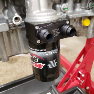

So our oil pump can support an external cooler with no Issues?
It would depend a lot on the sizing of the cooler and lines.
Edit:
Also you don't want the oil pressure too high to compensate for any pressure drop across the cooler. That can cause other problems with oil driven systems, ex. VCT. That and most oil filters are in danger to burst the filter medium around 90 to 100 PSI iirc, could even activate the bypass valve in the filter. Short version, unfiltered engine oil.
