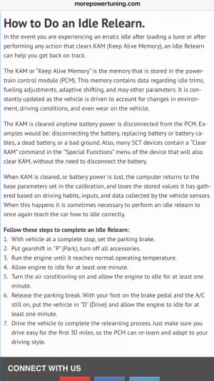

I ran torrie's tune and car didn't like it wanted to knock on the 91 octane here and I was beating the shit out of it. Plus 21341d4926c0c2ffbf99f294deb96922on fresh relearn. It was loosing fuel and dumping boost I had two torn boots arc off the coil but it was loosing pressure did all kinds of wierd stuff. Re load you tune with a good relearn . Add some octane.. see what it does I chased everything I could find info on what it could be. And simply added ethanol e85 to my 91. And it was able to get turned up. Also if you changed your plugs and had any boots tear or stick prolly should replace the boots gap should be .28 is what Torrie wanted my car.
