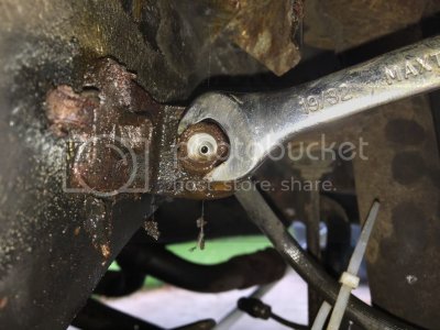

Hey, thanks for your ideas and replies...
I looked under the hood just to see what I was getting into and yeah, totally frusted, that's a new word I made....f**cked+rusted
ingenious eh??
Anyway, clearly going to have to redo the lines in the front too, looking at the rotors, the little bit of driving around the block I did and using the brakes some, you can see that not much was happening on both right side calipers, I think the master cylinder is doing what it is supposed to

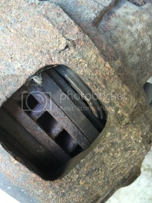

Here's an example of whats left on the front brakes

People usually give up on a car right after they have spent a lot of money on it, so there may be lots of new parts on it.
I would use the original rear brake rotors and pads. you may need to fiddle with those rotating rear puck / pistons on your new calipers to bring them out to compensate for the pad thickness that is not there. Do that little exercise befor you install, otherwise you have to keep taking the caliper off the bracket to turn the piston / puck.
Keep looking for close out sales at places like RockAuto and buy your new ones at a deep discount. Some rotors are coated so they don't rust on the cast surfaces.
Get your emergency brake cables working well while you are back there and grease / **** those few inches of exposed cable, and try to invent an outer casing to hold the grease in place, as that is where the cables become stuck with rust. Particularily when you let it sit unused.
And don't be like me and let that pig-tail return spring get away from you. I had to invent a system to put that thing back in place, as all the big name brake personnel just stared at me in disbelief when I showed them the detached pigtail.
