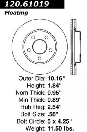

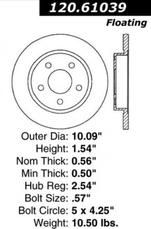

My question after this long diatribe...is The disks that are in the box are 1/2 in thick 10 in diameter,,no fins, just a solid disk plate, whereas the ones I took of the car this evening are 10 in diameter and are 1" thick.. The calipers and bracket look correct, definitely rear...but am I looking at front disks??? without the fins?? Or are these just a different generation? Can I use them if the calipers and disks are a set...Maybe somethings go mixed up?? Anyway, any info will help and save me some time I'm sure.
Thx,
Terry
9,045
4,390
Can't access the Centric catalog to confirm (and FordParts.com doesn't list MC anymore)
Centric 1993 SHO Rear (Motorcraft BRR51?)
51Fw Hprv0L
Centric 1989 SHO Rear (Motorcraft BRR44?)

hey, thank you very much for that great information… So the question is can I use this solid disk on my 92…? I guess if the caliper fits, wear it..huh?
The illustration shows the vented disk listed on '89, but mine came off s 92..and it shows the solid disk off a 93, but I know I've taken vented disks off my 93?
So maybe they are interchangeable with the correct caliper??

regards rear brakes 90 thru 95. from the factory 89-92 had 10" dia, 1" thick vented rear rotors. from the factory 93 thru 95 had 10" dia 1/2" solid rear rotors.
absolutely none of the parts interchange between the vented rotor systems and the solid rotor systems. the only common part is the bare ***** spindle with no mounting plate or hub attached to it.
the hub is different,
the backing plate is different,
the caliper mounting bracket is different,
the caliper is different,
the pads are different,
the dust shield may be the same. (what I suspect Tery calls a backing plate)
89s have their own unique rear brakes, the calipers & pads are the same 89 thru 92, but nothing else on the rear of an 89 fits any other year. for 89 only all 4 rotors are the same part. the spindle and hub for an 89 are the inner/outer roller bearing setup, the mounting plate does not have an offset like 90-92.
wondering
Fred??
what size vented disk on that 93??? a previous owner may have put a "kit" on for larger rotors, or replaced ALL the parts to get a 90-92 vented system.
89 vs 92 rear vented disks are similar, but not identical.

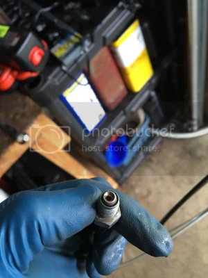

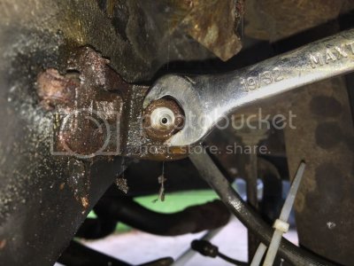

Well//, I figured out why they bypassed that part of the proportioning valve,..., they, or someone cross threaded the nut and then tried to fix it and made it worse, What's left of the threads doesn't start till halfway in the hole and I've tried gently a number of times and the nut threads just don't catch, it'd have to be rethreaded I think to be right. the one side looks kinda okay in the picture but the other side doesn't have a clean starting thread. I supposed it could be tapped , but so far, I'm still finding what I need either repairable on the car, or at the jy.
And of course, you guys were right...I could at least blow a high C on that fuel filter, ya can't get any air at all through the hydraulic hoses at all, so replacing those, but thankfully I'm getting better and taking off rusty things without tearing them in half...PB, patience, heat, and that trick where ya put a little tightening pressure against it first, then start trying to back it out. Also I think some light hammer tapping has been helping too.
Then of course as I was working on replacing the top line from the block to the hose, I look up the car and the bitch is dripping in that customary place where they put that stupid mount that hold the line up against the body, nice and tight where the water can just sit there and eat up the line...So I just took out the whole line up to the first big bend under the drivers seat, From there up to the master looks pretty clean. So..Splice in with a union on both lines and run em back to the block. The line going across to the pass rear up by the gas tank was also of course rotten, so I pulled that out. Weird thing was that the pass side hydraulic hose had a smaller nut holding the steel line in the hydraulic end than the drivers side. The hose looks the same but it is no question the next smaller fitting.

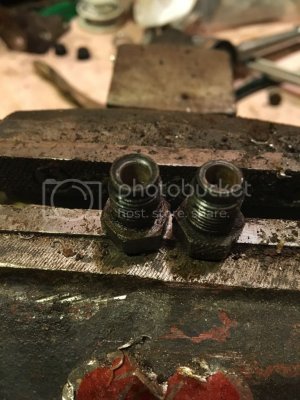

Anybody want to venture a guess why the ends of these two fittings are different. I thought maybe someone cranked down so ******* the left one that the flare kinda spread the opening?? These were the two top fittings on the proportioning block.
