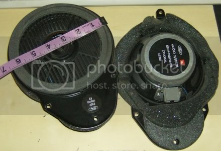

If it's a Gen 1, I have no clue. If it's a gen 2, then the rears are 6x8. You can certainly fit 6x9s in there by hanging them underneath and drilling four new holes (and cutting some of that carpet-y stuff). I did that on both of my gen 2s and it makes a heluva difference.

Gen 1's are also 6x8 and mount on a removable bracket that puts them up high near the interior cover above trunk and w/bracket removed 6x9's bolt directly into the body cutout (holes provided) and sit lower down and into trunk a bit.
