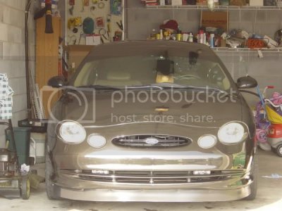

I ended up installing it AGAINST the natural curve of the professional landscape edging (how it was rolled up in the box) because of the 3/4 inch lip. How did you guys that have done this deal with THAT lip? It looks OK I guess:

I cut the bead off of the edging on a table saw. I think what I am calling the bead is what you are calling the lip? Then remove the back reinforcement piece if it is in the way.
I've noticed the new stuff has a arrow shaped edge that goes in the ground. What I use has a V shaped edge.

yeah, I cut the bead off too. I noticed Larry kept his (convention pics). Look "different". I was undecided, but with the bead, I thought I would be scraping EVERYTHING... so I cut it.
The lip I am referring to is on the other end. It is where the edging is folded over about 3/4 of an inch...(and it is the end that is made to go in the ground)

That is the end I "keep". I trim the edging to fit and use that V shaped end as the bottom.

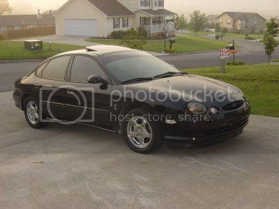

Looks good, i wonder if theres any way to mount it so you dont see the dimples in it? I have wanted to put something like that on mine though, i wonder if its look okay on a GEN II?

the dimples are pretty hidden... I was standing in my driveway, which is downhill from my car, when I took the pic.
I used a box knife on my first try at cutting off the bead :laugh_ti: I literally butchered the edging! Good thing it comes in 20 ft. sections. My second attempt was on a band saw. Took my time, tried to keep a steady hand, and it went MUCH better ;)

DavidT, any other pics of it on the car? I dont have a GEN III, but I'm eager to see. Ive been thinking about this for the GEN II for a long time now, just never knew what stuff to buy.. :evilgrin:
DavidT
Jan 10, 2002
3,415
15
TN
sure...

Paint it with "Fusion" satin black and it will look even better. I did this a while back. I left the bead on mine, made the dam lower to the ground and makes it more rigid as well, plus the bead is what scrapes so it is pretty durable, I like the look. I used a comb-like trim knife to remove the plastic anchor flashing for a snug fit.
