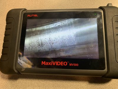

You need to scope the cylinder walls also. Here is what the inside of my cylinder looked like when i thought it was just the rings.
