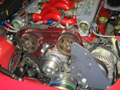

Snapped mine in the 89 several months ago....although I think the acc belts broke first and then the t-belt snapped. Driving down a rural road about 60+; hear a "whap whap whap" noise, a/c shuts off, hmm.....slow down and as I make a turn onto another county road "whap whap whap" again; lost power steering, then the car just shut off.....so maybe the acc belts breaking at higher RPMs with a sudden load change caused it. I have a pic of it but can't find it at the moment--will post if I can locate it. Pretty much just like YamahaSHO's.
