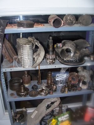

My question would be, had the crank been machined in any way?
I've seen this several times and it has always happened on a machined crank. I read somewhere that these cranks are roll hardened. the outer layer of material is incredibly dense and hard, but is only a few thous thick. Once you turn the crank and change the fillet radius, the crank is doomed.
This is a picture of our wall of shame.
103 0902
It showcases some of the crazy crap we've seen over the years. In this picture towards the bottom right, you can see a 2-piece crank that looks just like yours. It was also a machined crank that was in one of our early 3.2L MTX cars. So now, we only use ****** cranks for engine builds. There is no way to economically get the strength back in the unit.
Doug, a couple years ago when I had my mishap with a SC oil return line blowing off, I had left instructions with the machine shop NOT to turn down the main journals. As a matter of fact, only 1 rod journal that need turning down more than 10 under and 2 others that needed turning at all. However, when I pickup the “semi-assembled” short block, they had turned EVERY journal 20 under. While, they did bearing match all the journals using the closest tolerance, I was very leery. The machine shop owner assured me that everything was going to be o.k. That engine, so far, has 20K miles on it and has seen 19-20 psi of boost many times. Could be luck…....for a change.

it's only a problem when the crank is turned. When my 3.2l went sho-boom, there was half a rod wedged between two counterweights but the crank itself was still fine. When I drove the piece of rod out it spun on the journal just fine. The crank itselfwas just fine.
