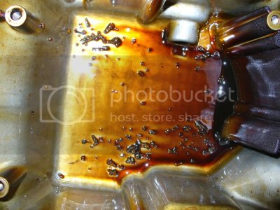

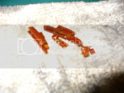

i changed out the motor mounts last night and got to drop the oil pan tonight and found something very interesting in the bottom of the oil pan which has me kinda worried something else is wrong. see pics below

thos are the biggest pieces i found, ill take more pics of all the smaller pieces in the oil pan tomorrow.

i dont know what to expect with how the rod bearings are going to look, ill found out tomorrow, but right now what really worries me are the little pieces of plastic i found on the bottom of the oil pan. and as far as i know this is the very first time the oil pan has been taken off.
i was just wondering what these pieces could be from, or if anybody has found anything like this in their oil pan before. i planed to clean everything out of the oil pan so none of this goes back in the motor.

kinda looks like the plastic off one of the cam chain tensioners. if it is the tensioner is down to bare metal OR was and has been replaced.
Edit: and it would probably have to be off the front head

when i had pulled the valve cover gaskets off back when i first got it probably about 145,000 miles or so the chain tensioner looked great, that might be what its from, i might pull the front cover just to inspect it, but it wasnt making any noises when i started the work, it ran perfect and smooth like always.
I concur, maybe it was replaced by a previous owner and the pieces where left in the pan?

X2 that is what they look like to me. Especially with the curved ends.

Imagine that x5 and that's what I pulled out of the SOHC in my Explorer. Id say timing chain tensioner too.

thats what i thought it might have been but i wasnt sure and wasnt sure if i should be concerned that it was in the bottom of the oil pan.
i guess i can clean it all out and she will be just fine.

the bits of plastic in the oil pan....

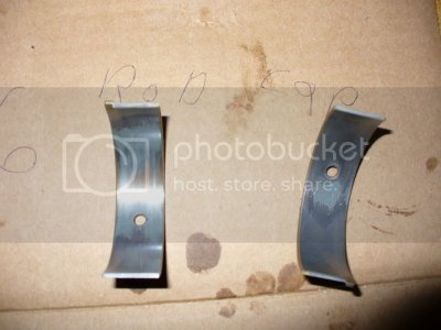

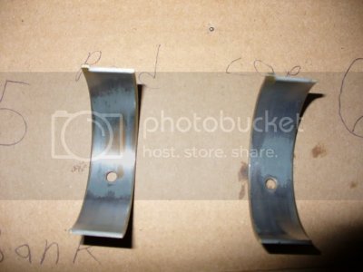

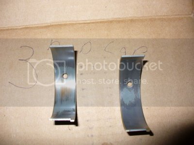

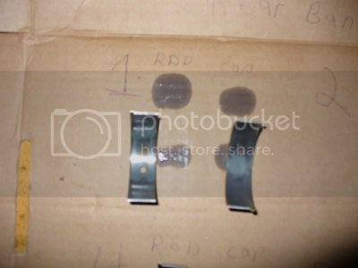

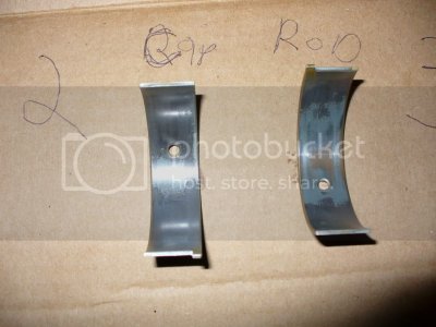

this are the rod bearing, they were changed at 189,380 miles. looks like the p/o (s) did regular oil changes they look rather god to me.
