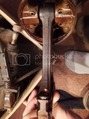

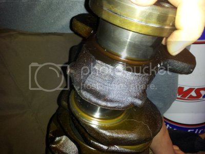

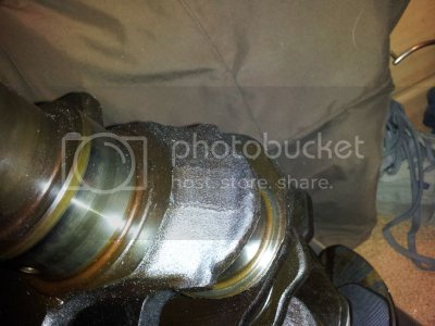

ok so according to these 2 sites www.chevytalk.org/fusionbb/showtopic.php?tid/244886/
http://forums.vwvortex.com/showthread.php?1172772-ABA-swap-help a large separating line indicates a forged crank. So i went out and grabbed a crank and rod.
2012 11 19104002
2012 11 19104058
2012 11 19104236
so it looks like the crank and rods are forged (yay!). so why is there a belief the cranks fail if you machine them down? if they are forged and then hardened why not harden the crank after its been cut?
another support for forged "A forging will ring like a bell when tapped on the counterweight with a steel hammer, while a casting will give a dull thud." sho crank has a nice ring.

i know the crank can take alot of power in standard size, but the consensus is if you cut it down it can fail due to loss of hardened material. that leads me to believe its just hardened...
ANY crank, whether forged or cast will be case hardened at the bearing journals. The typical way this is done is nitriding (carbo-nitriding) which deposits additional carbon and nitrogen in the surface layer of the material to allow for a harder surface than what is possible in the base crankshaft material.
The case hardening will nearly always be a very thin layer, so that any cutting down of the bearing journal will usually cut through the hard layer. I have done the calculations on the SHO crank, and if you turn the crank to the first undersize bearing available, you have a 50-50 chance of having removed all the case hardening. If you turn the crank to the second undersize bearing, you have certainly removed all the case hardened layer.
I should also point out that if the case hardened layer is too thin, under high bearing loads the hard layer can be peeled off due to the forces involved.
My point is that whether the SHO crank is forged or cast, the bearing journals should be re-case hardened if they are turned.
