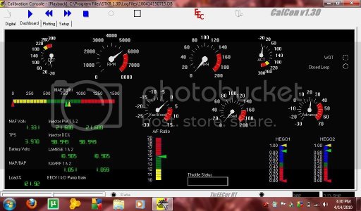

When I first started out I had the stock fpr, 155 fuel pump, and the timing was set back 5 deg with the afrs in the 11s with 5 psi. My injector duty cycle was at 98%.

I would never have run any boost without finding out where my injectors were. I definitely wasnt going to trust anyone on this forum to just tell me it was OK. So I datalogged at 3 psi where it was around 80% and 5 psi was at 98%. So thats where I stopped.
