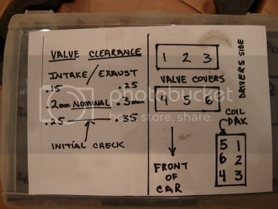

DSCN1015
this should do it for you! all Taurus SHO's have the same set-up. ATX(auto) & MTX (manual)
* Welcome to SHOforum & post some pics of your car when done, & you can be in them grandma...........

And as additional info, this is a wasted spark engine. There are only 3 coils on the coil pack. As long as 1&5 are on the back 2 posts, 2&6 are in the middle and 4&3 go to the front two pots your all good.
Most of the service manuals have the order listed wrong too, so this should fix the prob for ya

Thanks again for your help. I decided to check the car myself. It was hard to
find the plug wires in the back, very tight. when I was finished I found that the
2 and 3 wire were switched. I put them on the right number on the coil pack
according to the diagram you sent and took the car out. It has been a long time since it ran that smooth. No pops or radles. I can do 45 without having
to down shift into 4th gear. Up a hill at 35 in third gear no popping. This should also help the gas mileage. Thank you again.
