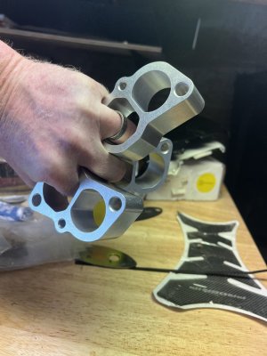

I started to 180 the intake as well. Seems like I’ll need to remove material in belt cover or get some 1” spacers made. I’ll look it up next. With 3D printing I’m wondering if spacers could be done cheaply. I know it has to be a certain plastic.

I would steer clear of 3D printed plastics. With it being that close to the motor, it will see pretty good heat. ABS will have issues around 175*F. Poly-carbonate will get you to about 300*F without issues. For PC you will need a printer that can sustain 260*F. This is on the upper end of most hobbyist systems. You still may end up with issues over time. I would look more at some of the companies that make heat shield spacers for intakes and figure out what they are making and if they can make spacers or talk to a machine shop about some aluminum spacers.
Great info. Thx.
I have a thick of phenolic, a mill and some time as well. I think I could make a set based on the gaskets in a few hours.
But hopefully I get a set with some other parts I need that were offered up a few days ago.

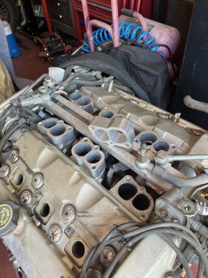

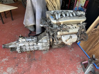

Well I finally got back into the project.
Parts a thought would work I bought from another here turned out to not work at all. Wrong bell, wrong clutch, wrong risers. Measure twice lesson learned.
Turns out it needs 32 mm rises to turn the intake 180*and 3.0 ford Ranger transmission. Standard ranger 3.0 clutch, and 3.0 starter.
I went with stage 2 clutch kit.
Sho motor goes in this week with any luck. It’s slightly shorter and only slightly heavier than the 2.3 w auto.
