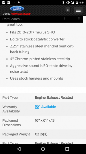

Well as we wait for the video of the sound did you guys notice on the Ford racing site that the exhaust is available for the 2010-2017 sho...!
Sent from my Nexus 6P using Tapatalk
E9f4b6910959e8a193b8cbccadc2984f
Yep, Ford introduced that at the Ford Nationals in June.
I wonder how many folks have gone with that set up.
