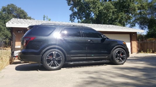

You mean these?
B0aa261618bc18498a3f54a4a8668159
20x9 w/44mm offset, OEM tires are 255/50-20
Bolt pattern 5-114.3 and centerbore...63.1mm
Wheel and tire combo weight is about 74lbs, not sure what the rim weighs by itself, but likely in the low-to-mid 40lb range. Great looks, super heavy...
