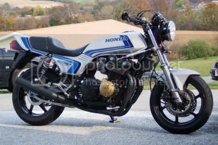

SuperHO, you're sooo right!! I could just save that coin, get another $15 Summit Turbo like I mentioned above and spend the rest on that starving African kid. And what do you know,.... here's a pic of one of mine now!!
SchuleInstallf
Just don't tell the wife! :naughty:
