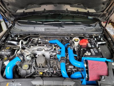

Finally got everything installed! That clamp was a big B!!! I had to use a 12" flat head screwdriver from underneath the car, but once i got that stupid clamp out it was smooth sailing until it came to installing the air box, filter and the 2 pipes that go into the air box. I looked at other people's pictures of their install and they were able to get the ckamps on the outside of the box but I couldn't do that cuz the pipes would only go so far into the filter so I had to clamp them inside of the box. Everything is solid and doesn't move so I guess it'll work.
I took it for a little test drive and i can hear the turbos spooling up and I love the sound of the bov! This is my 1st turbo car so I have been driving around and letting off the gas just so I can hear the bov's. The car feels like it pulls harder but that could just be in my head. D7960ffd042c7d6d6595213a70ce2444
Looks badass! Good job buddy! Oh I'm sure she is more responsive and has more lungs on the top end than before. It's not just in your head
Thanks!!! Now to decide what will be next thing to do?
