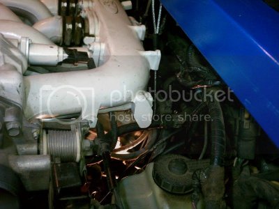

So this is the setup I have in the back.
I just ran the hook through the back strap?
(had to push my spark cables out of the way, it's by that passage).
Download1 zps0acdbfdb
7,521
well, hooking it to the intake strap is not the best choice.
I would find a way to get the hook/strap around the exhaust manifold or on a bolt to the head rather than the intake.

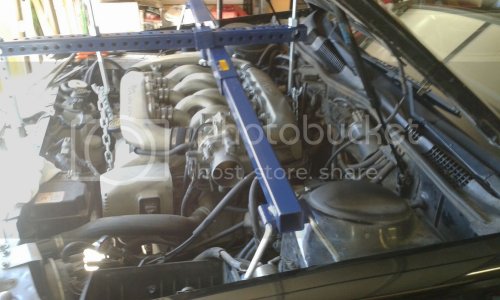

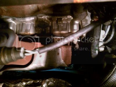

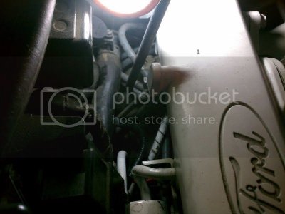

So I got the supplied cables around the exhaust manifold.
The are 1/8th inch braided steel cables.
Does this look legit enough?
(Only one shown in the photos, I got the 2nd one the same).

Throw those cables in the trash.
Also never use the hooks to hold the engine while you're underneath it. Only use them to help angle the engine during re-assembly.
Get two ~4 foot pieces of 3/16" chain and attach them to the heads where the bottom intake brackets attach (M8x1.25 gr10.9 bolts), and run the chain over the support bar.

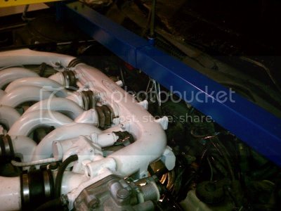

Download2 zps78eaf5f2
Thank you! This made the most sense, the fact that I could just use the bolt holes for the intake bracket on the head was visually descriptive enough to find! Bought some bolts and chain and now I don't feel I have a >90% of dying! Yay! :thankyou:
Update:
Engine is hanging just fine! :D

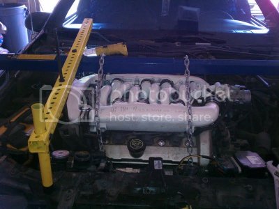

Here is what I did.
2points zpsb0a3147d
used 3/16 chain to intake bracket bolts on the head
