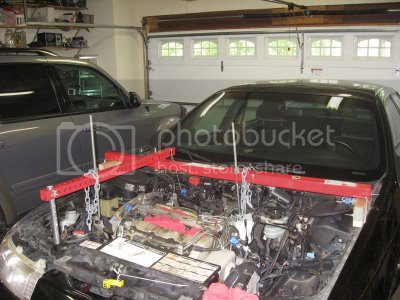

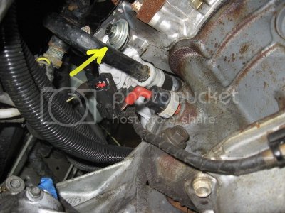

Hey. Ive got a question. On the video, it's telling me I need an m8 by 1.25 bolt for the support bar. I cant figure out where to put it. I'm looking under my car to see if I spot the hole that the video is showing but I cant find it.

Behind the rear cylinder head on the left side. The chain can come around the back or around the end of the cylinder head. Cushion it from the valve cover with rags. The chain does not show in this photo, but you can see the bolt location where those big flat washers are.
IMG 2008
This shows how the support can be rigged to the engine. I recommend adding extra chains or straps for reducdancy so there is no way the engine can fall even if one lift point gives way.
IMG 2000
13,266
I never did that job without already having the motor out of the car so I don't have experience with supports like above. However, It's just like using a hoist where you can attach to several bolt locations (heads or block) as long as the area can support the weight.
