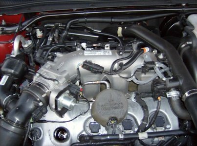

And, not to necropost myself, but what is the huge can-looking thing on the front valve cover that says "UP"?
hawkeye18 said:
It's hideous. Can it be moved? lol
That is the high pressure pump for the DI system. A low pressure pump sends fuel from the tank and then that thing pumps it to over 2175psi into the injectors. It is mechanical and runs off of a rounded square shaped lobe on the cam, so no it cannot be moved. The cap over it is actually another cover with an inch or more of insulating foam, to try and muffle the tapping sound from it. The main engine cover is pretty thick of sound deadening too. I swear it had to have weighed around 15lbs, at least. I could barely hold onto it with one hand while I was taking the pic with the other.
edit: here's a super high res pic of the EcoBoost torn down: http://www.drivingenthusiast.net/sec-ford/FMC-engines/6m35d-ecoboost/EcoBoost_ExploView_02_HR.htm. If you look at the intake cam on the left side, you can see the square lobe in the center of it, which powers the pump. The pump is in the picture just up and to the right of the cam (without the insulation and a fuel line coming out of it). I've also added a link below my engine pic to the higher-res version.
