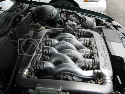

People have said the wheel paint doesn't chip as easily and it's also rated at high temps since wheels can get very hot from hard braking.
Anyway, here's the best (to date) picture I have of mine. The silver is engine paint, gray is wheel, I didn't use any clearcoat. I don't think the silver is as shiny as it used to be, I wish I had clearcoated it. I've used wheel paint on a ton of bike parts too, I like the stuff.
