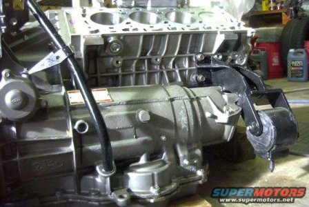

On the drivers back side of the block is a pipe plug, 3/4" IIRC. It is the same as what the oil cooler coolant lines use on the bank 2 side. You can see it here on the #4 cylinder area.
Bank one side of block w tranny 2

thanks, actually just looked it up on the schematic last night. There's a million lines in the way to its tough to even feel for it from the side. I'm wondering if it is reachable with the intake off.....
