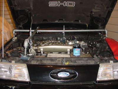

There's also the "Nick Chrimes" metal pipe version that you can download the instructions from here:
Here's a picture of it:
Support
Nick claims it costs about $25 and 1/2 hour of assembly time to make. I'm pretty sure his $25 price estimate is based on Home Depot prices.
edit: Nick claims the picture isn't exactly like the instructions. Ah ****, here are his words verbatim:
My instructions can be found at: www.shonutperformance.com/clutchvideo.htm by
clicking on the links. Note that the pic is not identical to the instructions, but you'll get the general idea.
Folds away when not in use, and much less bulky than 4x4s. The one 4x4 design I know of (as per the SHO NUT clutch video) takes longer to install on the car and has a single suspension point whereas mine has two suspension points which
gives you greater flexibility in angling the engine.
Regards
Nick
