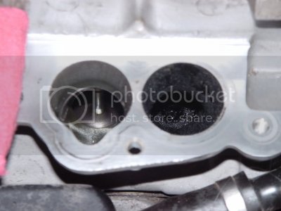

I'll be very interested to see the results of their intake cleaning process and products. I have a similar gripe about my SVT Contour.
Guess which port has the fuel injector? This is near 100K miles.
DSC02264
This I believe is a combination of EGR and the V6 Duratec's known hyperactive PCV system. I solved the PCV problem with a coalescing oil trap in the crankcase ventilation line, just wish I'd done it a long time ago. The PCV goop also collects on the back of the throttle plate and causes it to stick in the bore, I'd taken to pulling the throttle body and cleaning it every 20K miles to keep it from sticking. The oil trap cured this problem, but getting the built-up crap off the intake valves and ports is a real challenge.

thx for the pic gary, man what a difference between those two valves........
and yes catch cans are great ideas to stop some of this from forming
Disgusting, ain't it?
and yes catch cans are great ideas to stop some of this from forming.

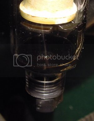

Don't want to derail the thread, but here's the coalescing oil trap I did. It's a Parker/Balston 10F11ED with 1/4" pipe ports. They're about $50.
Th DSC02244 Th DSC02243
Here it is after just 250 miles. I have to empty it about every 1,000 miles. It doesn't look like much, a teaspoon of oil every tank of gas, but atomize that and smear it all over the inside of the intake and the valves...

So is this why Shell has their nitrogen enriched Vpower stuff to "reduce" this?
All the fuel additives/chemistry in the world won't help with reducing intake/port/valve deposits on a direct injected engine. In a DI engine, the fuel is injected directly into the cylinder, unlike a port fuel injected engine where the fuel is injected in the intake ports above the valves.
In port fuel injected engines, the fuel wash over the ports and valves will generally keep them free of deposits, but there's no hope for this in a DI engine.
The deposits you're seeing in the linked pictures from BG are a combination of oil mist from PCV flow and exhaust by-products from EGR. I'm assuming the ought-10 SHO engines have both EGR and PCV? The variable valve timing may eliminate the need for EGR. I'm not fully up on the nits and details of these engines.
Go back up an look at the pic of the intake port from my CSVT. This is a completely split port engine with the fuel injector in the low speed port, and uses a butterfly further up the intake manifold that allows air into the short runner/high speed port above 3500 RPM. The high speed port doesn't see air all that often, probably far less than 10% of the time the engine is running, yet that valve is just thoroughly caked with deposits. The valve and low speed port with the fuel injector is surgically clean.
The V6 SHO engines are similar design, but the port is siamesed just as it enters the cylinder head, both valves see air flow all the time, and the fuel injector washes the whole siamesed port and both intake valves, so if you use decent fuel and fuel injector cleaner religiously, the whole mess stays clean.

that looks like the water seperator from air compressor lines they sell at Lowes.. is that that piece? If so that is the WRONG piece as it is only rated to 150deg F.

that looks like the water separator from air compressor lines they sell at Lowes.. is that that piece? If so that is the WRONG piece as it is only rated to 150deg F.
I didn't get it at Lowes.
As I'd posted, it is a Parker 10F11ED, purchased from Parker. It will remove water, oil, and submicron particulate from an airflow. I'm not ignorant on this stuff, I have plenty of experience with removing aerosols from pneumatic and high vacuum systems, stretching back to my first job in 1982.
http://www.parker.com/portal/site/P...extcat=10F+MINIATURE+COALESCING+FILTERS&Wtky=
I was aware of the 150F inlet temperature limitation when I embarked on this experiment, however, these devices don't cease to function or self-immolate at 150F inlet temp, they just may not work as well as intended, and may allow some mist to get past the trap. I was willing to live with that.
I measured the inlet temps, and subsequently installed a near 4 foot length of Aluminum tubing on the inlet line that wraps down and back up the firewall by the brake booster. If you've ever seen an SVT Contour engine bay, you'll understand why I don't have a photo of this particular piece of tubing. I lost a lot of knuckle skin just installing it. Think of it as a KISS intercooler.
I know there are plenty of shiny, colorful, expensive catch cans on the market, but I have no idea how effective they are, and neither, I suspect, do the folks who make them. I used equipment that I know works, and it appears to work well, as I can't find any traces of oil film in the intake anymore.
Your concern is appreciated, and now that I know how often it needs emptied, I've substituted a metal bowl for the clear polycarbonate bowl. ;)
