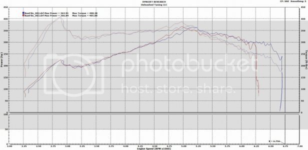

Torrie's printout of the two best runs, overlapping.
The best run overall... with the highest performance. Note how everything peaks in the 5,000 RPM range.
Moser3
I will post the actual paper printout I received from Gulf Coast Motorworks, with a boost graph sometime tomorrow. Usable boost peaked at 17.72 on this run.

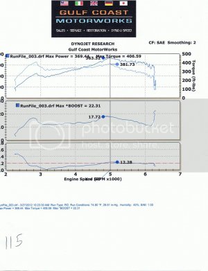

Here is the paper printout of the 115 Torrie Tune.
Note the Power Scale is 0-400 and the Torque Scale is 0-500. The peak boost of over 22 occurred when the blow off valve opened when the Dyno Pull ended.

Hey, nice numbers! I'm an old Gen1 SHO enthusiast from the late 90's who long ago migrated to the realm of turbo Mitsubishis. Knowing nothing about the new SHO other than turbo/awd I have to ask - why do all your dyno pulls start off with a rapid spike in power and torque around 3k RPM? Is it the automatic transmission, boost spike, or what?
Are the SHO turbos variable geometry, HTA or anything fancy like that?

It's because they lock the vehicle into 4th for the dyno runs... Truthfully, real time results on the road would be different. Max would be similar, but Flex or any other vehicle that has more than one gear, will be in the 4,000 to 6,500 range in all gears, hence the curves will be higher and more flat. Dyno runs are in 4th.. I end my 1/4 mi runs in 4th also.
Turbos boost is based on the sensor, the blow off setting and the rpms. I was running a 3 bar sensor that allows boost readings over 15 psi. Also the valve timing in the EB Flex & SHO is not variable, like the EB 150, which has larger turbos and piping. Consequently it produces over 400 lbs torque as stock vs. the 350 that SHO & Flex produce with smaller turbos.
