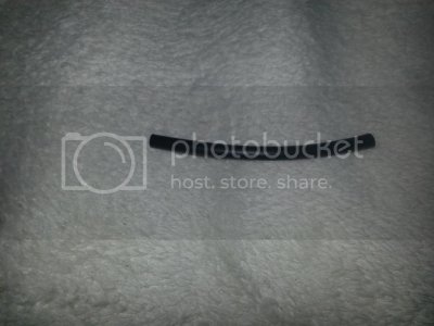

Update, I just pulled the lower radiator hose and it came right out..........................that and a whole bunch of sediment. I guess I'll still replace the radiator anyway. Thanks guys for all the tips and help. Your a real life saver!!! 20130509 191336 zps70fb2b20
