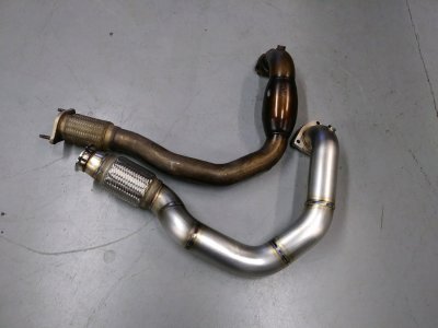

I would recommend looking for an exhaust shop in your area. I ended up paying about $1200 for my 1 off set with install/gasket/hardware.

The stock DPs are so small that doing that would probably not even be worth your time or saw blades to cut it.

While I do disagree that they provide minimal gains, as I have seen plenty of times on customer cars where they provide up to a 3 tenth gain in the 1/4, there are other avenues to take for better gains given the current standing.
We used to keep 6-10 sets in stock of the SW catted pipes, but with steel shortages and boats stuck at the ports we are looking at the end of November for our next shipment. We ordered a set of PPE pipes for a customer last week and we were quoted 12-16 weeks, Merry Christmas!
Honestly the best **** for your buck on this platform currently is an XDI-EVO HPFP. Order it, current lead time is 2-3 weeks, install in under an hour, load E30 tune, and run bottom 12s with no other modifications other than map sensor and plugs. Downpipes and intercooler are good depending on your climate, but also highly depend on your tuner choice of if they will make that much of a difference.

I gained about four tenths after installing the catted PPE downpipes.

I went ahead and ordered a set of catless pipes from JM, vivid said 15 week lead time….so next year will be nice
