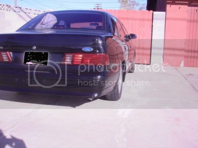

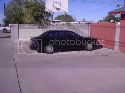

After putting on '95 knuckles and new front struts I took my '89 in for alignment. Big O said they were able to get the front perfect but the rear was at 2.25 percent and sitting too low. They recommended that I put on new rear springs and eccentric bushings, bring it back within 30 days and they would re-align for free. I like how it sits and rides, so I put on eccentric bushings and brought it back. They were able to get the rear to 1.5 percent, which I can live with. Big O said the alignment is closer, but still sits too low, bring it back with new springs and they will do it again. I asked if I put on another set of eccentric bushings or adjustable rods, would they still do it for free? They were being cool and said sure. My question is do you guys think this car sits too low? or too low in the rear?

If there not lowering springs, they are sagged. You would be better off getting some adjustable control arms to get it aligned the way you want rather than using the bushings.
GM GTP arms fit the SHO with a sleeve kit from SHONUT. If you search it I am sure you will find lots of info on this.

The rear does look like it sit pretty stickin' low! I Personally would get new Struts and Springs to increase the handling of the car and once the new setup had broken it should ride just as well if not better! But its just my two cents.

It's actually setting fairly normal for a Gen1 SHO. Here's a photo of my 91' with 16" Alloys:
Most of the sinking look is actually a simple illusion because the rear wheel opening is smaller(and less flared) than the front. :salute:

I assume you are meaning 2.25 degrees and 1.50 degrees, not percent. 1.5 degrees is perfectly fine for a street SHO as long as they have enough toe-in.
I think the rear is perfect height, you just should lower the front an inch.
There will be no performance improvement with new springs that raise it up, because the car will sit higher it will not handle quite as well. the spring rate of the springs doesn't change, they just take a 'set' so the free length is shorter and therefore the are slightly shorter when compressed.
