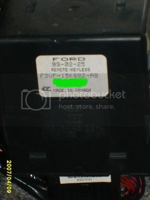

Does it have a keypad above the driver's side lock?
When you open the trunk and look at the back wall on the driver's side, is there a medium-size black box with a sticker with 5 numbers on it?
If the answer is yes to either of these, then you have remote keyless.

And in that box theres a big wire comming in , it looks like an antenna wire/plug. Plus it should have a 5 digit code printed on it.

this is what the RKE(remote keyless entry) system would look like if you had it, with the trunk open, you are standing towards the front of the car, this is on the lower left area of the rear seat back.....
this is the best pic I have sorry, shoulda took one zoomed out more

Keyless entry (the doorpad buttons) and remote keyless entry (keyfobs) are different. If you don't have the keypad on the door I would guess that the door has been replaced, does it have the sticker with the VIN on it still? Does the VIN match your car?
Anyway, all 93+ SHOs have the remote keyless module, so all you need is a remote. They're about $25 on ebay.
