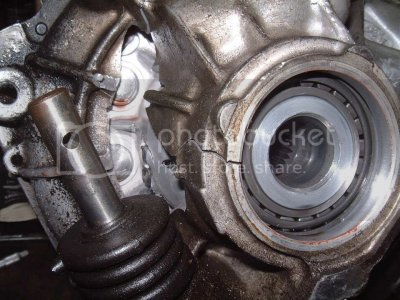

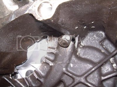

If you are taking it apart i would use transfer punches instead of rolled pins, just went throught the whole exploded tranny game.
DSCF0325
DSCF0327
We used a transfer punch, drove them in and staked the holes over to keep them from walking out, got photos of them to just not availible ATM will post later

Don't underestimate the strength of roll pins...

That Photo makes me want to cry!!!!
That's 1 less MTX4 in this world!
Don't do burnouts people!!!!!!!!!
You can do burnouts with these! :evilgrin:

Wasnt a burn out, was shifting from second to third on on ramp, roll pin walked out about 1/2 way and sheared
Minnesho
i was wrong
May 22, 2005
1,631
MinneSHOta
when my diff pin finally blew through the case i was just cruising down the interstate. i noticed it felt like it was slipping a couple days prior, was probably just the pin hitting the case.
