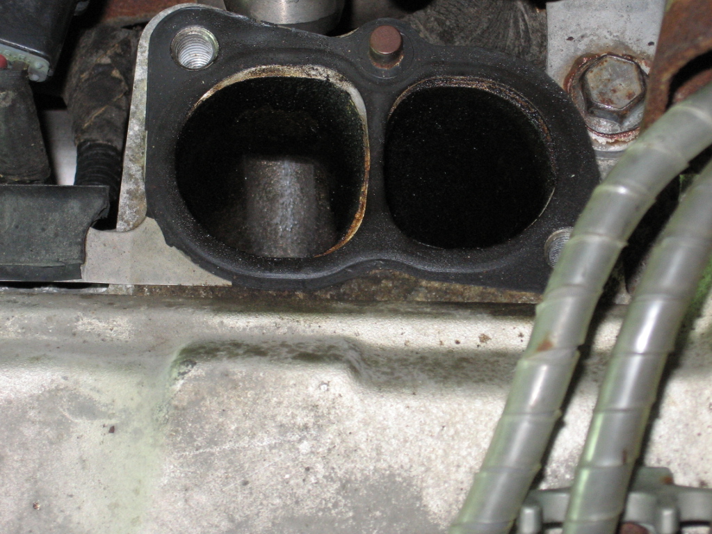

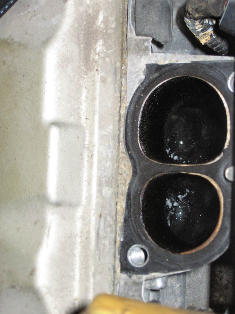

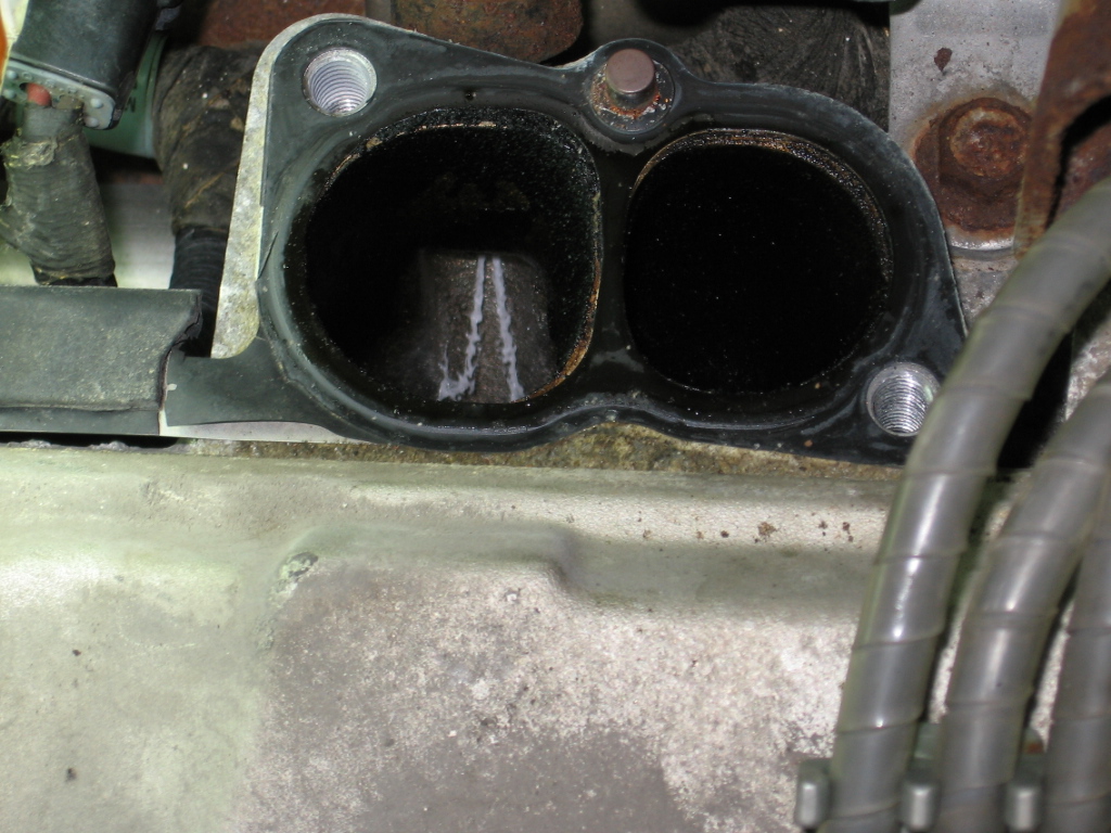

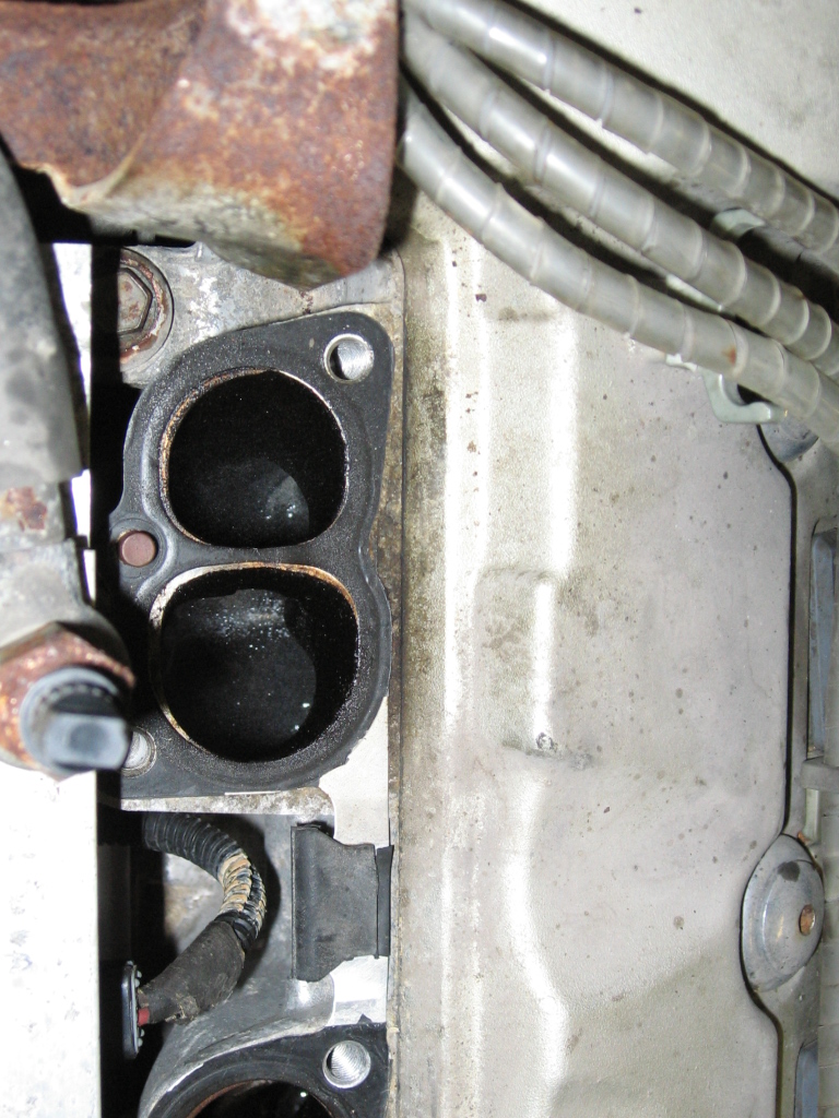

*THESE PICTURES ARE SHONUTS AND NOT MINE*
http://www.shonutperformance.com/Stock_Injector_1.jpg
http://www.shonutperformance.com/Stock_Injector_2.jpg
http://www.shonutperformance.com/ACCEL_1.jpg
http://www.shonutperformance.com/ACCEL_2.jpg
top 2 pics are stock and the bottom 2 are the 3 hole accel injectors he sells
**** i am shocked how bad the stoke injectors act since the pictures josh has posted make it look like the stock injectors just shoot in the ports like water guns. we already know the better the fuel mixes with air the more power is made.
