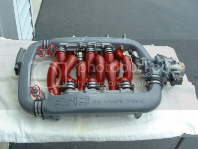

The crossover tube (The part of the intake that the DIS is bolted on to) is also part of the ground. You have to make sure that the area's of the Crossover tube that are bolted down are clean of any paint. (By the bolt holes) Also, make sure that you put heat sink underneath the DIS, as to not overheat it.
Here is the pictures of the area's that need to be cleaned of paint, Any part where the bolt/washer meets metal (And just those areas) . Everything is circled in red.
Intake
-Sam

You guys are Gentlemen and Scholars...Lol.. Yup the braided ground had a bad...ground...So i moved it to the Top red circle in the above picture. and it started right up. Thanks guys...Now my Tach isn't working...Haha. That's not on my top list of things to do. Ill Upload some Pictures of the Intake it looks Really good.
