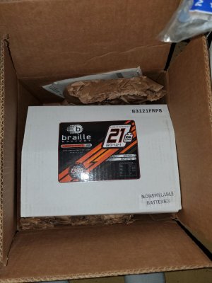

20220428 002734
My solution to the problem arrived today! Might be a coating of snow tonight and was quite windy/rainy this evening. So I'll likely do it tomorrow or Friday eve. I figured it was a good excuse to save weight. Unfortunately I'll need a winter full size for my climate. 550 CCA isn't going to cut it if I need to run it mid winter.
