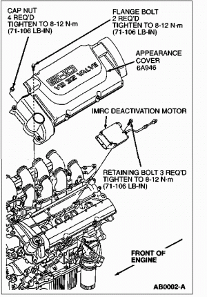

Hi, you're lucky that the bad coil is on the front, it will take you like 10 minutes to fix it. first disconect the battery,second remove engine vanity cover(the one that says V8 SHO) 4 nuts and 2 screws(10mm) socket,third remove 2 (8mm) screws on top of the coil (second coil from driver to passenger side) and remove the coil,put the new coil in place. Put everything back and enjoy your ride. Hope you can get your new coil cheap, otherwise youll pay betwen 90 to 150 for it. :thumb:
A pic to follow that up:
