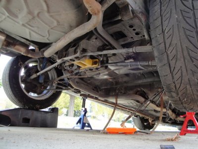

I have cut a couple of access doors and have always used an air cut off tool. Just start out very shallow and slowly get deeper with each cut until you are through the metal. Just dont go through the metal very far because of the fuel lines. If you dont like the idea of sparks, you can also use an air hammer to cut it.
As far as sealing it up. I put hinges on one side and made a small lip on the other with a scrap of sheet metal. Put a small slide lock to hold it closed and sealed up the edges with duct tape. Works like a charm.

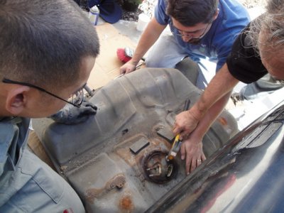

I made the cut running from the hammer handle toward the passenger door first in that last pic with no fear of hitting lines. Then slid a piece of 1/8" masonite/plywood in to cover the lines while making the other cuts. I used a dremmel,(Same as Adam) went slow/patient and barely touched the wood. Then made some holes and riveted the plate back down half lapping the opening with scrap hvac sheetmetal and caulked. I can and have already gone back in and just had to drill out the rivets to do it.

I used a dremel with a cut-off wheel. Took forever, but the wheel literally cannot cut deep enough to nick the fuel lines, so beyond sparks this is about the safest method involving rotary tools.

I used a Dremel w/ cutoff tool and, if careful not to go too deep, you can do it safely w/o damage to fuel lines. fwiw, I hinged mine at the rear, rather than the front as shown in the photos above.
I would not use duct tape because the adhesive will dry out after a few years and the tape will come off. I made a couple of little metal pieces that I screwed down to the "flap" to anchor it, then used strapping tape to "seal" it up.

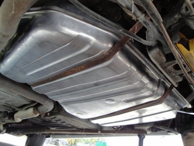

I've dropped my tank, it's not as big of a deal as it is made out to be, as long as the bolts aren't rusted. It helps to have the car up high and put a jack under the empty tank. Preferable in my opinion to accidentally cutting or drilling the tank and having a big hole in your car body.

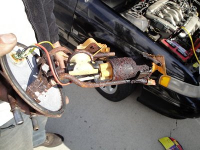

X2, just drop the dang tank. Do it right and forget all this ghetto butchering of the body. If the pump has never been changed, its a good opportunity to wash the tank out with purple power so it's factory clean. It's about a 30 minute job to drop the tank, and it eliminates concerns about nicking lines when cutting that hole.
I'm running a Bosch pump. Works just fine and is quieter. It does not come with the strainer, but you can get those separately from NAPA for $5-6. Also, the locking ring o-ring that came with it was oversize. I re-used the original.
