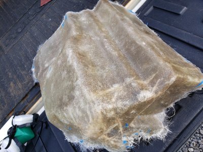

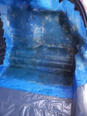

Today I taped off the right back corner, got a general idea of where I want the sub to sit, and laid 2 layers of fiberglass.
If I'm being completly honest, I think I used too much resin and not enough hardener (4 drops per oz). It was only about 50-60 degrees today but after a few hours this stuff is still extremely sticky. So I'm now hitting it with the heat gun and kicking back a few cold ones as I **** time.
I hope by the end of the night I can remove the shell from the trunk and tomorrow I'd like to add a few more layers to the base to give it strength. 1 oz chop is lighter than most people use so I expect it's going to take a lot of layers. I have a sassy wife and 2 girls... I'm practically made of patience.

Mostly. I just checked this morning and my hand doesn't stick to it but it doesn't feel completely solid. I started to try an peel it out but it doesn't feel strong enough to support itself yet. Guess the next layer will go on inside the car. I'm going to double up on the hardener this time.

Layer 3 is in. 8 drops of hardener per oz of resin. It's about 50-55 degrees outside today and I decided to do this layer outside so I don't stink up the garage/house. Yesterday I poured the resin on and primarily used the roller to spread it. Today I poured it on the brush and dabbed it on the fiberglass. That worked much better.
Hopefully I can remove the box today. My back would appreciate that. 81d07f290962cf9114923dcafb8a3782

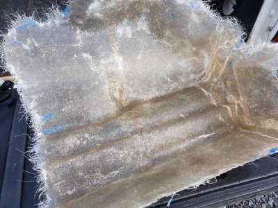

The bottom layer was still wet when I took it out. At first I thought this thing was ruined. It wasn't difficult to remove most of the tape (because it wasn't cured) and luckily I was able to hit it with the roller and it began to cure fairly quickly. 4fda7faf2685f7d1f52fbc8e65bf8cf2D7062985a3fbba6a66bb380f3ef9e0ca

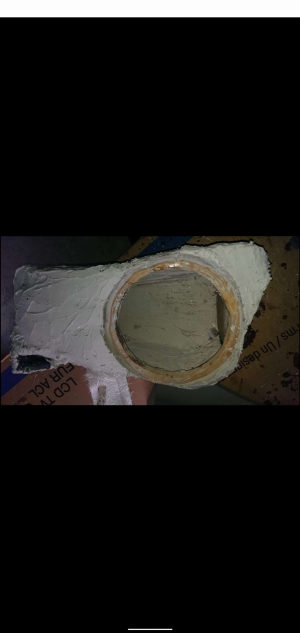

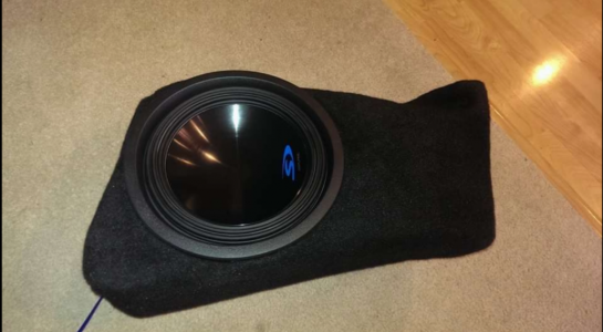

Do you plan on using body filler on it? I did just to give it more support turned out great I used only two layers of thick Matt
I just used the case from the noise cancelling sub.
Type s dual voice coil wired to 2 ohms because I didn't know of any amp that was 1200 1 ohm stable.
As you can tell the carpet hides any imperfections very well although this was a hidden sub.
Excited to see how you're is going to turn out. Screenshot 20200308 125827836fa9bb65028f23f19711eac30cde217e1016505b8ac80b45a1a0acd8e0cfc1
Excited to see how you're is going to turn out. View attachment 12193836fa9bb65028f23f19711eac30cde217e1016505b8ac80b45a1a0acd8e0cfc1

Wow, that does look good with the carpet. I hadn't planned on using body filler but I may have to. Is there any in particular you would recommend?

Any body filler will work think I used something cheap that I got from the paint store that had the chopped Matt but I have used bondo and that was fine too think the bondo might have been easier to work with but it was my second time and kinda had a better feeling of what I was doing.

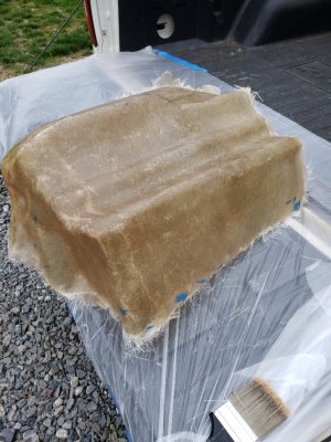

4th layer is on. I went with 10 drops of hardener per oz this time. 9 drops might be the right #.
I'll probably water test it tomorrow to get a feel for where 0.66 to 1 air volume falls. I'll shoot for somewhere in the middle.
I'll put in wooden dowels on the flat spots before the next layer. It should be strong enough by the 6th layer. 56d8280166a8fb600bfd98ddbfcd25ef

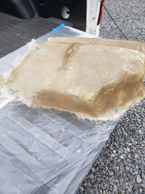

I had some bubbles that needed addressing. So I dremeled/sanded those on both sides, patched some light spots on the inside, and added a layer to the outside. It's beginning to feel solid. 1 gallon of resin won't be enough using this 1 oz fiber.
Maybe I'll have more time to work on it this week with the apocolypse and all. I'm interested to see what work says tomorrow.

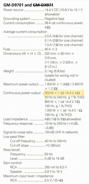

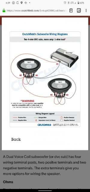

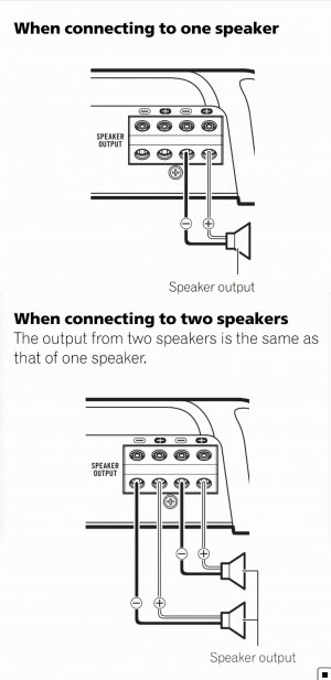

I have a question for some of you audiophiles. My speaker is DVC 2 ohm, rated for 500 watts RMS and my amp is a Mono, rated for as much as 1200 watts RMS at 1 ohm. My speaker is wired in series, exactly like the first picture. So I should be getting 500 watts RMS at 4 ohms. I'm about 99% sure it's wired correctly now and nothing needs to be changed. I've not had any distortion issues wired this way and it produces pretty good bass (hopefully more when I finish this sealed box).
If I decided one day to buy another sub and both subs where wired in series, does it change my ohms at all? At that point, both speakers would be at 4 ohms and they would be sharing the 500 watt RMS from the amp, right? So they'd each get 250ish watts RMS?
Now, let's say I wired both subs in parralel. At that point, the amp would produce 1200 watts RMS at 1 ohm and each speaker would receive about 600 watts RMS? Since this exceeds the rated RMS of each sub by 100 watts, I assume this is a big no no? If I turned the gain way down, would I be ok or should I still not consider doing this?

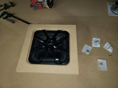

Didn't feel like itching today so I decided to cut out the MDF rings (squares). They're not attached yet and I still need to do a lot of sanding. I don't have a router table and doing it by hand isn't working.
Once I get the inner ring how I how I want it I'll glue the two together, square the edges on a table saw and potentially round the edges. I feel like I can hide any sharp edges under fiberglass. 3df0e66c286a6d7e9b18dfc1a4e0ee53

No problem at all. But you can't run both subs in parallel and then connect it to the amp. The amp because it is mono would see a .5 OHM load. Wire them both in series and the amp will see a 2 OHM load. 4 OHM for each woofer. Which would be 800w rms 400w to each woofer! Perfect!!
