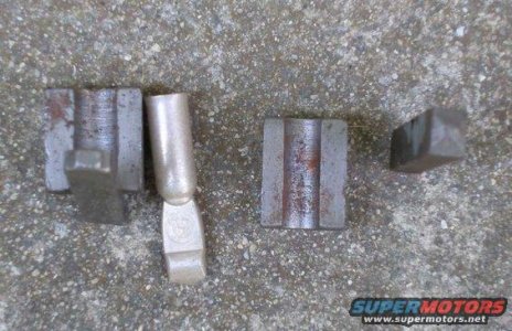

Here is what I use. I make my own cables using scrap #4 SOW wire and quick disconnects. The lug is shown in the pic. The smaller die is for a smaller lug.

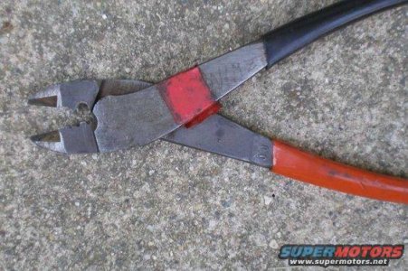

For regular terminals that are for larger wire I use the hand crimpers but set it down on the concrete and whack it with a hammer a couple of times.
