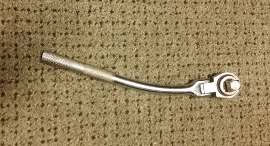

See attached. Cheater pipe + crank bolt > wrench.
I had another wrecking yard that after lots of trying by me and their mechanics, they rolled a compressor out to the yard and used a big Earthquake impact to finally bust one loose.
You can also put a bit of torch heat on the bolt head itself for 30 seconds or so, not enough to heat the pulley or melt the rubber of the harmonic balancer, just enough to lengthen the bolt and loosen its grip. Put a battery charger in "start" mode on the fully-charged battery to boost the current the starter motor can draw.
For locking up the engine, you can look up "rope trick", but you must be able to determine the cylinder is at TDC with valves closed so you don't bend one. Or a lockup tool, but I don't know if I'd trust one not to bust off or put a hole in the piston with this kind of force needed.

That's a badge of honor there.
