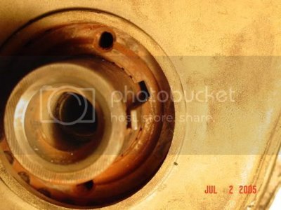

I've been having trouble lately in that my MTX won't rev past 5k in any gear, have had a slight hesitation even noticable in 5th, and the tach is a little sketchy upon startup (even though there is no trouble with the car starting). I finally decided to check the timing real quick and found the rust dust.
Immediately I thought "the cancer" and went to investigate the harmonic balancer. The bolt unthreaded easily by hand, and the pulley had walked out about a fifth of an inch.
I've used 3 different balancer pullers, and the dampener won't pull off! I can't tighten the bolt to push it in.
DAMN YOU CRANK CANCER!!!!!
But, if the crank is shot, I'm pullin it off the road and swapping in the 3.2 I've got. hehe
THANK YOU CRANK CANCER!!!!!
