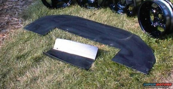

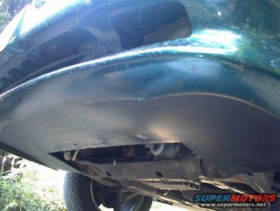

Paul N., do you know what the material is for that air deflector you posted the photos of?

I made that out of corrugated polypropylene, AKA plastic cardboard.
I have two Hayden oil coolers that work good for the coolant lines. 1/2" fittings and if you made the above air deflector, the cooler can lay flat on it with a cut out below it. This will force air through it when driving and when sitting still if the radiator fan is on it will pull air up through it.
