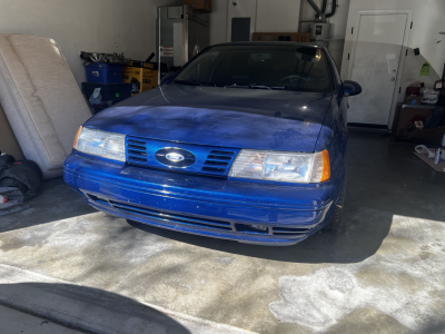

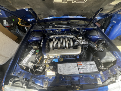

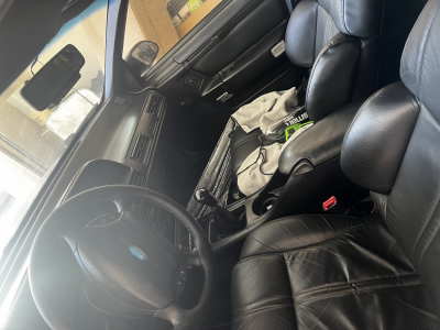

pics for attention...

That's a beautiful color on your SHO! On the 1990 there's a dropping resistor for the fan. As mentioned above, if you only noticed one speed, I'd suggest checking for an open fan dropping resistor. All the control for the radiator cooling fan is through the CCRM and the PCM controls the fan based on engine temperature as well as for the self test, so I'd not be inclined to suspect an issue with the PCM yet since it does activate the fan for the self test.

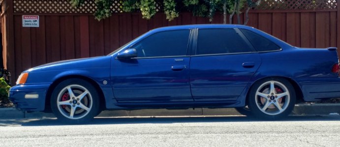

Probably a bad ECT sender. Everything else should be fine as the fan works on the self test. But I put a new Durarast SU201 in this car in 2019, So it may be a bad circuit or ECU.
IMG 20190616 151633223 HDR 1024x445
