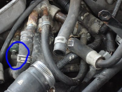

I realized this is the v-8 section so my picture is incorrect. but im assuming it looks similar to the v-6 one since mr.a said is a one wire?!?
