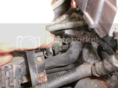

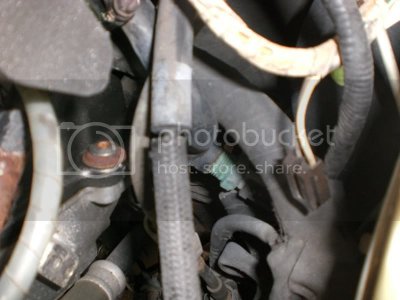

There are actually 3 sensors. The third is by the firewall on the drivers side.
Here is the one you need to replace (one wire connector)
010 2
Here is the sencond one. As Hawkeye stated. (black connector)

And the 3rd by the firewall. But you should be fine just replacing the first one. (all green looking)
009

No, there are only two sensors.
The third illustrated (green) is the CELO (Cold Engine Lock Out) switch. It is a component of the EATC that will lock out the A/C compressor function until the engine warms up a bit.
It is recommended to not attempt removal of that switch from the heater pipe.
