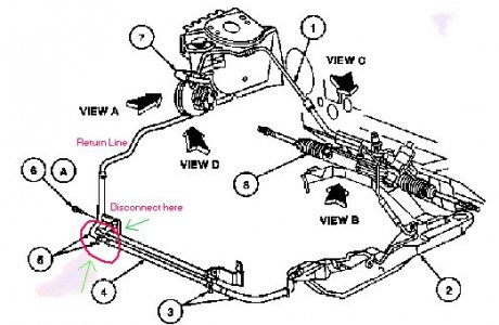

2) Steering's been REAL tight, squeaky, jittery, whiney, etc. from a start for the past couple months. After a few minutes of driving and turning, it becomes much smoother. Same shop tonight, the guy says the pump is leaking. The problem I have with that is that I haven't put new fluid in it in years :nut:, and the oil changes haven't reported low levels. I did the front brakes recently and when the car was up with tires off, I started the motor (to pump pistons back to engage pads). I then turned the wheels left and right and they moved smooth as silk. So if the pump's leaking, how is there still fluid after all this time and why does the steering smooth out after warm-up? (I think I know --> needs fluid changed). Does anybody disagree with my assessment? Could these symptoms indicate a leaking pump? I read up on v8sho.com where to disconnect for draining the PS fluid, but not completely sure about which hoses (http://www.v8sho.com/SHO/psflush.htm). Murdock says driver's side, but Nimz says passenger side. Hmmm . . . Here's a diagram:
SHO ZF ZUA PS

The PS sounds more like a rack problem. The pump internally is very simple and unless a bearing is bad probably not the problem. Obviously if you are not adding fluid it's not leaking. It only holds a pint or so of fluid.
To drain the fluid just unhook one of the PS cooler lines. No need to have the motor run as you cannot fill it fast enough. If the fluid is dark and dirty then just suck out the fluid from the reservoir and refill with cheap ATX. Keep doing this until it stays clean. It may take a few weeks of changing for this to happen. Once clean then drain and refill with quality ATX fluid.

UPDATE (coolant reservoir and flush): Got the coolant tank from RockAuto ~ $40. Went in easy once I realized I could pull the large hose at the bottom toward the rear of the car to get some slack so I could remove the clamp (I had already disconnected down below to flush the coolant, so it was free to move through the conduit). I didn't blow the old coolant through the water pump as instructed by Mr. Nimz, just refilled with tap water, reconnected, let it run a while, shut it off, let it sit, flushed that out, then did the same thing with 100% distilled water before finally filling again with distilled water. Let that run in the car for a few days before throwing a bone to the local shop to do a coolant flush (I gave them my word I'd give them some business and they were running a valvoline special at the time).
(power steering flush) Did the power steering flush per Paul's post in the v8sho link above. Must not have put in enough fluid before going out for a test drive and with steering VERY difficult at times, I kept hearing a sound like nuts and bolts rattling in a tin can every 4 or 5 seconds. Back home, topped it off, sound went away. That was about two weeks ago and steering is MUCH better, and maybe most importantly, FLUID LEVELS HAVE REMAINED THE SAME. I'll be doing the turkey baster suctioning of fluid from the reservoir method for the next couple months to try and thin out the remaining bad stuff that was in there, then it'll be another full flush with good ATF.
