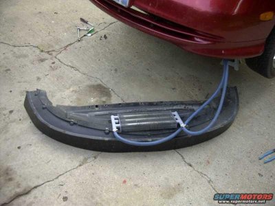

290 said:
If you wanted to get crazy with it you could run it to a trans cooler. You get a small addition to the cooling system right before the oil cooler and you dont have to worry about the hose kinking, just a thought
I use to do that. :)
Oil cooler coolant cooler
